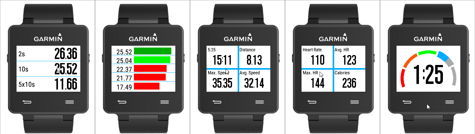

    I just double-checked and all other values are shown ok. I take the distance value (and all other values) from the activityInfo which I get on every onUpdate() call.
    function onUpdate(dc)
    activityInfo = Act.getActivityInfo();
    if (activityInfo != null)
    compute(activityInfo); // just calculates some windsurfing speed statistics
    Currently the only need for 1.2.0 is the drawArc function I use in the race-timer:
    http://www.chumba.ch/garmin/ws_app_vivoactive.png
    Anyway, I'll test with the 1.1.4 SDK and also with the vivoactive. Is that the right thread for that or should I do a separate one?
