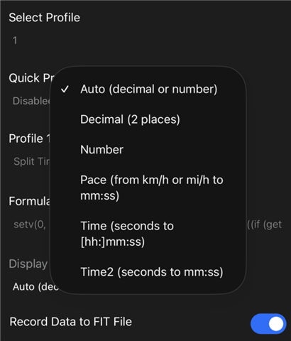

2. Estimated Split Pace (500m):
Using the estimated distance, split pace could also be derived:
  • Split Pace (500m) = Elapsed Time / (Estimated Distance / 500)
This would allow users to see a familiar rowing metric even without a connected rower (maybe even use it with the virtual pacer?).
