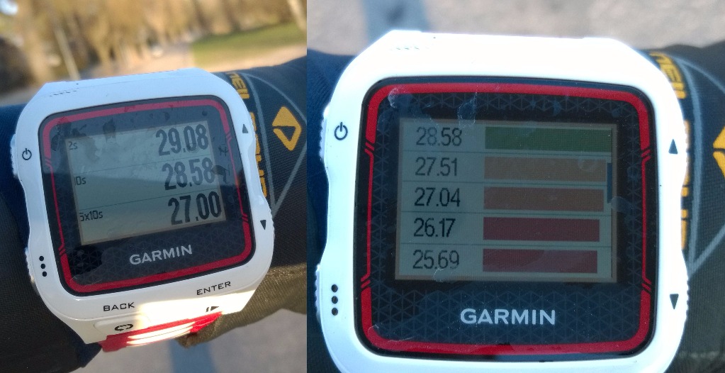

    Here is a picture from the current version of the windsurfing datafield. If used in a 1 field layout, then it looks like that:
    http://chumba.ch/images/garminapp.jpg
    I still need to optimize for readability. The datafield also shows the 10s of the last leg/run after a turn for 20 seconds. If going more than 36 km/h then it shows the speed with the number thai hot font. After testing I found that very handy.
    In other layouts it shows the 2s, 10s and 5x10s averages alternatingly every 3 seconds. It also works with the vivoactive and epix, but the vivoactive doesn't save .fit files with 1-sec recording. So it can be a helper only.
    The other one shows the 5 best 10s averages. The colored bars just show how close they are to each other. The greener the better :). It works much better than my Ambit versions so far!

    I like the Forerunner 920XT a lot! The display is very easy to read on the water and in the sun. I can see numbers a lot better than with the Ambit while windsurfing.
    There is no problem with the Forerunner 920XT: It has GPS updates every second and also saves them into .FIT files every second. The .FIT files can be uploaded to www.ka72.com directly and loaded into GPSResults directly. So I'm very happy with this. The numbers in the watch matches very well with the resulting numbers from the analysis software.
    I think I can upload the apps to the Garmin App Store next week. They are ready but I just have to take some screenshots and write some description.
    Currently just the vivoactive (another Garmin watch) has a problem. It updates GPS every second and displays numbers correctly every second, but the .FIT files contain information every 2-6 seconds. This is because it is using smart recording.
