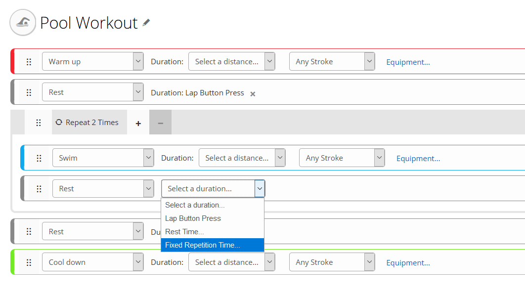

  • Got it. I was just wondering where the repeat time is specified, as it's the repeat time that's constant (right?) not the rest time (which is "repeat time minus last lap time").
    Looking at this thread it seems that the repeat time can be specified in a swimming workout definition.
    Say you want to do 100m intervals. You can set the interval such that they repeat every 2 minutes 'Repeat on 2 minutes'.The amount of rest then is a function of how fast you swim and the time remaining. Swim 1:50 for the 100, means you get 10s rest before the next interval starts on 2 min.
    Testing this in Garmin Connect, I see that the "repeat time" comes from a field Garmin calls "Fixed Repetition Time" in a swimming workout (which is unavailable for other kinds of workouts).
    If Garmin were to support this feature for non-swimming activities, they would also have to change running (and other) workout types so that a fixed repetition time is available.
