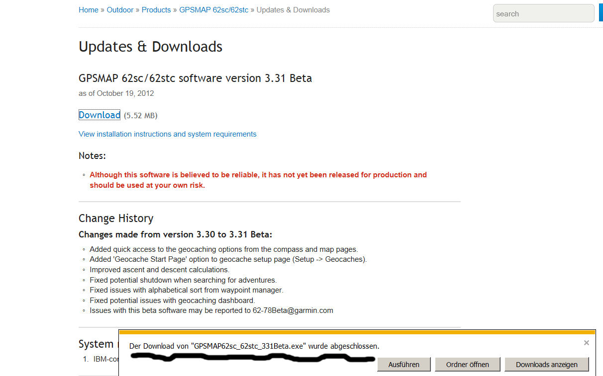

GPSMAP 62sc/62stc software version 3.31 Beta
Former Member
Former Member
as of October 19, 2012
Changes made from version 3.30 to 3.31 Beta:
  • Added quick access to the geocaching options from the compass and map pages.
  • Added 'Geocache Start Page' option to geocache setup page (Setup -> Geocaches).
  • Improved ascent and descent calculations.
  • Fixed potential shutdown when searching for adventures.
  • Fixed issues with alphabetical sort from waypoint manager.
  • Fixed potential issues with geocaching dashboard.
  • Issues with this beta software may be reported to [email][email protected]
  • [/email]
>>> Download

    Gerade versucht, aber die Seite scheint wohl nicht mehr zu gehen, kann download nicht anklicken....
    lg Janine
  • Former Member
    0 Former Member over 12 years ago
    Habe es eben um 19:10 Uhr getestet- Kein Problem mit Download ?
    L.G
    R.
