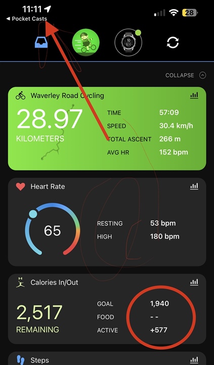

  • Another failure today. Two screenshots, one as the Edge syncs and another shortly after, presumably as the Fenix syncs. Check times top left - active calorie correct from Edge but then suddenly lower. Surely the fix here is that if a device is recording an activity it overrides whatever is being logged by the non recording device?
    Second question, the Fenix is set as my primary training device - what is the impact of changing this to the Edge?
    Come on Garmin, please respond and help us resolve this issue
  • I have tried changing the Primary device to EDGE, but same problem...
