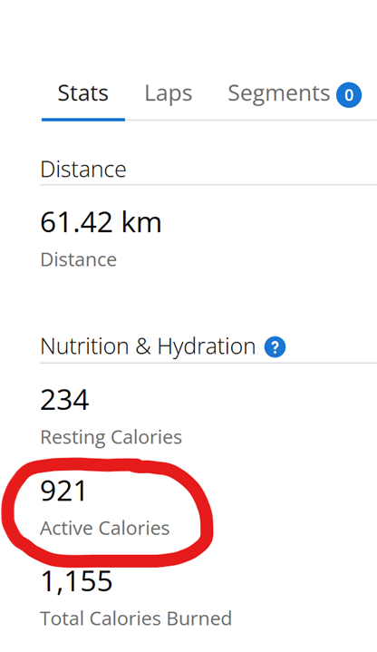

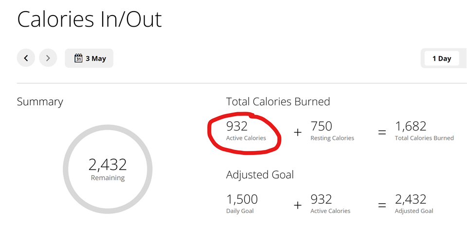

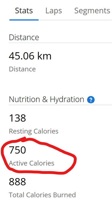

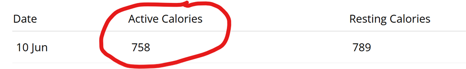

  • Next experiment
    Today again with EDGE 1050 and Fenix 8. All calories on the ride were generated by the power meter only, as I put on my  H10 belt but not the pod Face palm
    I recorded a bicycle ride on the the EDGE with power data but no heart and simultaneously recorded a walking activity with watch OHR. At the end of the ride I saved the EDGE ride and discarded the walking activity. The EDGE recorded effectively the same calories as I would have expected if HR had been included. After fully synching  all devices calorie balance still looks good.
