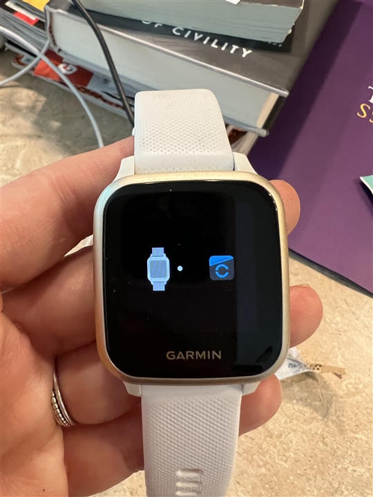

Completely out of the blue fail to connect my Garmin sq with my Huawei p30 Lite (( it all started after my watch requested a bluetooth update this morning, I confirmed, it was obviously installed. Some time after I noticed that my watch was still disconnected despite the fact that internet was on.. But I did not think of it as a problem until I realised it stayed disconnected through the day while Internet and bluetooth were on! (( I went through all the steps of troubleshooting... restarted both devices, then unpaired the watch, and removed it from Garmin Connect, deinstalled Garmin Connect, then attempted to pair again - not happening, the search for device goes round and round. Got tired of continuously restarting my watch, then my phone and over again... Just why updates on Garmin is causing so much distress? Please Help? SOS! What do I do next to fix it?

    No matter what I do (done both versions of resetting the device) and Bluetooth just won’t connect or hold a connection. I’m having no other issues with any other Bluetooth devices, just Garmin.

  • I did that the partial reset but no luck, then did the full reset that wipes all data.  My Venu SQ and Garmin Connect on my Samsung S9 finally found each other.  But 5 minutes later my Venu SQ is no longer connecting and the control panel shows a gray / blue flashing phone & bluetooth symbol.
