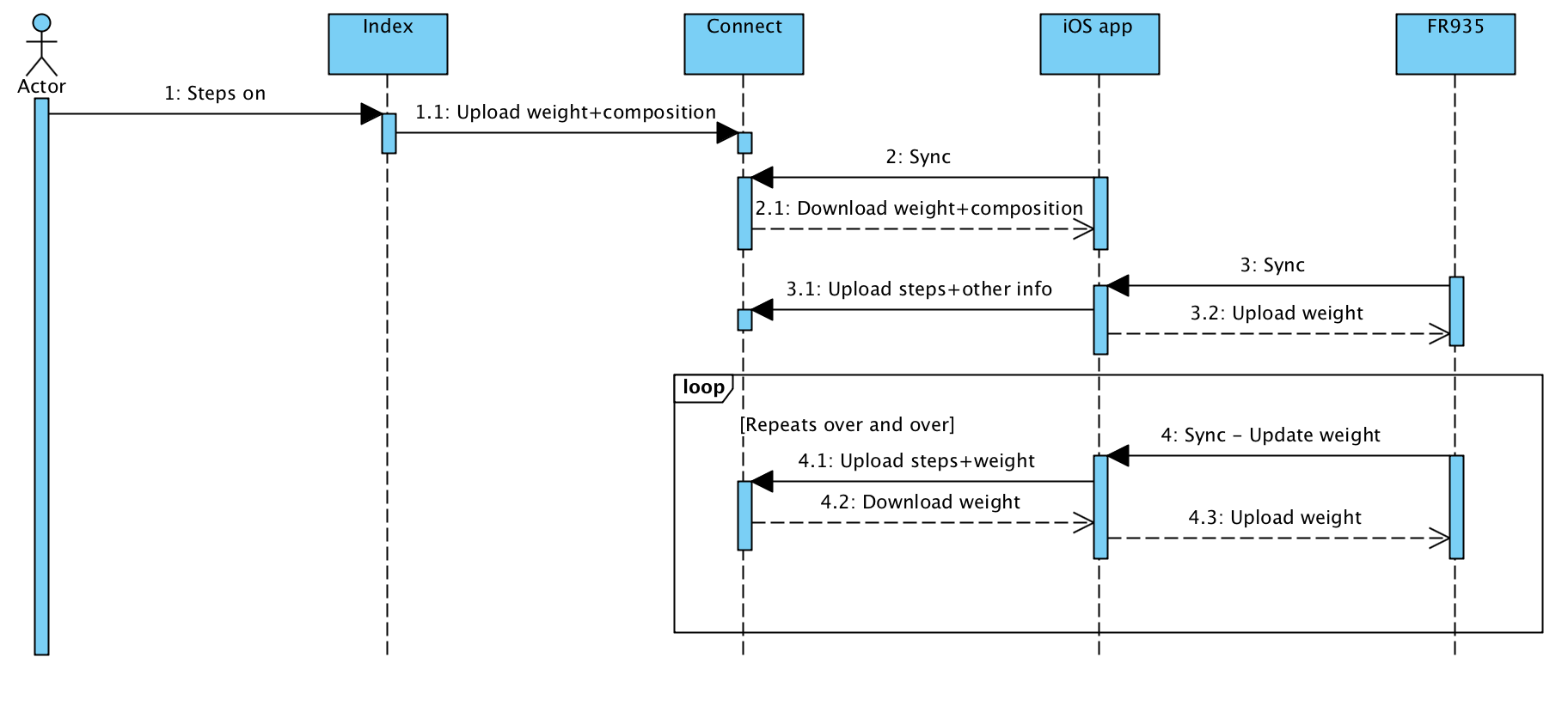

    I'm experiencing the same issue, and I think JulesMedina is correct, the problem isn´t with the Index, but with how weight data is synced back to Garmin Connect. The watch will get updated weight data from a Connect app, and the upload that same data back to Garmin Connect overwriting the data from Index.
    I have attempted to illustrate the steps in the attached image.
    I also contacted Garmin support, but haven´t heard back yet. Will follow up tomorrow.

  • @JulesMedina: See my post above. It used to be the same for me, but ever since upgrade to firmware 7.60 on Fenix 5X, it disappears even if not connected to MFP.
    Because it happens on so many different watches and the dates seem similar, I would guess the problem is on Garmin Connect itself, and the way it handles syncing. Probably syncing back and forth too much, then syncing 'weight' as a group. Normally, you would only have weight and BMI, which is all that other devices / third party apps would sync back, leading to blanking of the other fields (which can really only be populated by the Smart Index and only syncs one way, that I am aware of). That could also explain why it gives trouble with MFP and with some firmware. That is one (unsubstantiated) theory, anyway.
