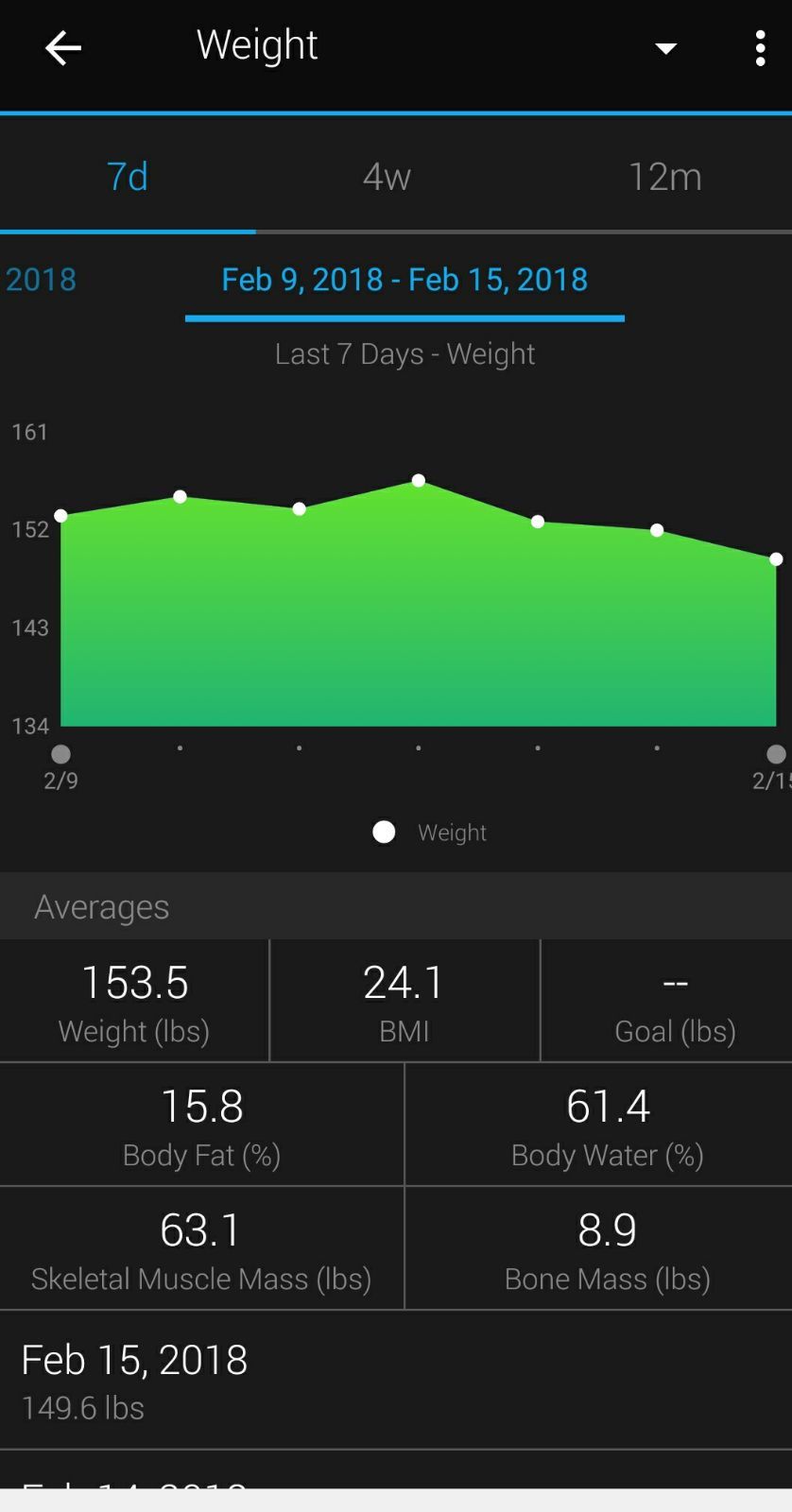

  • This is my screenshot of my GC. I got my scale 7 days ago. No missing data. I weight on it and I go to my phone and refresh and its there.ciq.forums.garmin.com/.../1310498.jpg
    Do yo sync activity/exercise with a watch?
