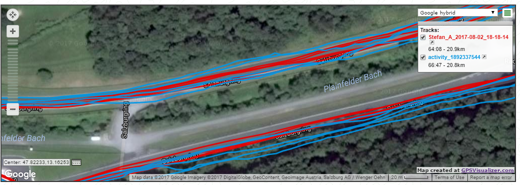

    GPS accuracy disappointed me. I?ve compare some trainings with my Polar M400 (which costs less than a fourth of the Garmin 935). I had gps+glonass on at this training.
    I do a second test today on the same track without glonass.
    red M400
    blue FR935
    a good source is also http://fellrnr.com/wiki/GPS_Accuracy FR935 is in the lower fourth of all tests...
    i seriously thinking of selling it...
