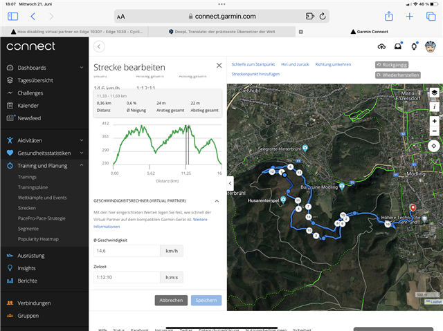

Where in Garmin Connect is this option located?
On Garmin Connect (Web or Mobile) goto trainings -> courses
-select a stored course
-edit the course
-at the bottom you‘ll find a field to set the speed of VP
Garmin guidance
https://support.garmin.com/en-US/?faq=9aaItduDZd4rzKRriZKTp9
tells of another possibilty via VP widget on your device.
