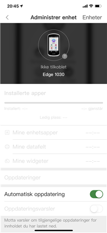

    By using Connect IQ I mean the garmin app. I can sync to GCM and there is connection between edge and phone but if I open to see installed widgets and apps in CIQ it is only greyed out. Fenix is connected ok. Cant use the the app for
    administrating edge at all.
  • I'm assuming you have iQ apps and/or widgets on the device, yet the GCM app doesn't show these in the device section of GCM.  I've had this happen and usually a sync when I know the GCM is connected to the device, resets the GCM app so it sees the apps/widgets that are on the device.  When it didn't, I resorted to doing the entire clearing out of the GCM app off the phone, logging out of GCM prior, than dumping all my BT settings, phone and device.  Pain in the butt.

  • Still no luck :-(  No connection to Garmin's Connect IQ app and still two different training loads. One from edge and one from fenix. And edge does not upload to strava anymore. A bit frustrating, this. Maybe try a factory reset on edge.
