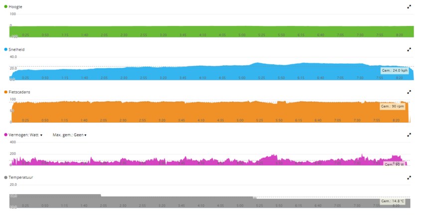

  • Test with Edge 1000 = no dropouts
    [IMG2=JSON]{"data-align":"none","data-size":"full","src":"https:\/\/i.ibb.co\/KDqrNtb\/1000.png"}[/IMG2]
    Test with Edge 1030 = dropouts...
    [IMG2=JSON]{"data-align":"none","data-size":"full","src":"https:\/\/i.ibb.co\/74jJNXd\/1030.png"}[/IMG2]
    This is ridiculous, please fix this Garmin
