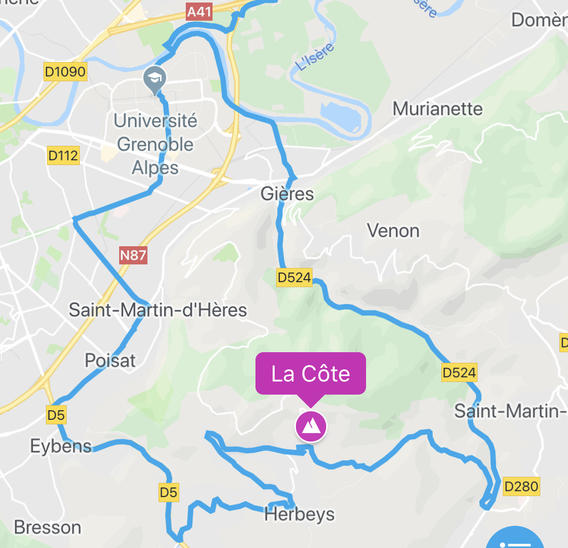

I recently got a 1030 to replace my forerunner 920xt for cycling.
I often create courses on Garmin Connect, with some waypoints to highlight climbs tops.
With the Forerunner I was able to see the distance to next waypoint, but no way to get this info with the 1030.
This only thing I have is the distance to the next turn. So useless when you globally know where to go...
Is there any way to display the distance to the next waypoint set in Garmin Connect? ciq.forums.garmin.com/.../1440604.jpg
