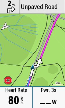

I'm seeing my 1030 increasingly trying to route me onto unsuitable roads when it's in Road Bike mode and is set to avoid unpaved roads. It does this whether I set it to popularity routing or not. The screenshot is from the road through Richmond Park in Surrey, the road is one of the most popular cycling routes in the world and is part of the route ridden by 20,000+ cyclists every year in the RideLondon Surrey 100. I don;t understand why my Garmin is trying to take me off the tarmac and onto the unpaved road.
I'm on Firmware 5 and 2018 maps.
Is anyone else seeing this? ciq.forums.garmin.com/.../1366434.jpg

  • Interesting and I've certainly seen that but I don't think this is the same issue, as I was navigating to a point rather than following a course.
    It doesn't matter whether you are following a course or not. The problem is just more apparent when it happens when following a course.
    People wouldn't normally know it picked the "wrong" road because when they aren't following a course. In your case, you know it picked the "wrong" road because of your expectation it wouldn't be using unpaved roads (otherwise, you'd have no idea that it picked the "wrong" road).
    It appears the deviation off the road is the shorter path.
    Routers basically work by determining points and then finding the shortest route between them. The "avoidances" stuff works by virtually "deleting" the roads with the characteristics you don't want.
    If the roads/ways were tagged as "unpaved" in the Garmin map on the device and "avoid unpaved" was being uses, the unit should not have used the unpaved road. Ideally, the unit should display unpaved roads in an obvious way.
    When you are using a course, the unit doesn't use the "avoidances" settings. The course is supposed indicate the roads you want to use and including avoidances would cause the unit to "second guess" your choices (which would be really bad).

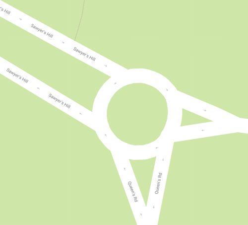

    If you look at the road from the roundabout from Sawyer's Hill to Queens Road, you'll see in the following that the oneway arrow is wrong.
    https://ridewithgps.com/routes/27889655
    Popularity routing won't override going the wrong way.
  • Which one way arrow? The ones I can see look correct (we drive on the left in the UK), although i see your route has taken a different direction to mine taking a slightly off road route, not sure why that is.
    The one in my link (obviously).
    There's something funny with the routing data.

  • The one in my link (obviously).
    All the arrows are correct in Ride with GPS
