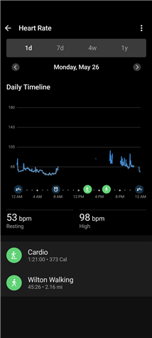

4) Lost 20 minutes of heart rate in the middle of a run tonight. This has never happened to me on any Garmin watch. My wrist was sweaty but....

  • Thank you for starting this thread. I was coming here to report exactly the same issues. I thought that the rebooting issues were associated with using the timer then it was the maps but in the last few days it has been happening almost at random. I have also noticed that when the reboot happens the watch does not transfer the heart rate data to the Connect App resulting in large gaps of missing HR data. However, the watch has the data so not sure why the HR data is not being transferred. This data loss is mirrored in the web too. Anyhow, I feel like a Garmin beta-tester. Coming from a 4 year-old Venu 2 which had none of these issues I feel that this is an expensive downgrade! These seems typical for early Garmin product releases, unfortunately.
  • With the 4th issue, have you tried downloading the activity data from the Garmin website and then view the HR data on the FIT file viewer website? See if the HR data is missing when displaying it there.
