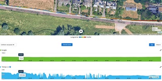

The altitude measurement is constantly jumping up & down with variations between ±80 meters. Also while sleeping, see attached screenshot of the watch screen. This leads to highly overestimated height data during trail runs and number of floors climbed (although it’s good for my hill score.)
I also noticed that my running pace is pretty inconsistent over short periods of time, see attached screenshot from Garmin Connect. Strange enough the GPS map plot seems just fine, the pace is not consistent with large variations in speed while I was running in a steady pace.
