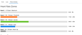

  • When you look at the % in each HR zone in Connect for these runs , are they similar ,or have the HR zones somehow got altered in 22.xx .  Weirder things have been known to happen. if the max HR and HR zones got inadvertently changed with one of the 22.xx versions....

  • I understand that , I am asking if you look in connect under the activity , what does it show as the % in each zone for the 22.XX activities and the Prior activities.  People have reported that the Zones got altered in teh settings, If this happened and Garmin shows the zones strangely then this would affect the calculations by Garmin. So maybe just look out of interest as the % in zones on teh activities and compare.

  • No what I am saying is , if you look in the activity on GC web interface , it shows % in each zone recorded with the Activity . Just take a look and see how they compare across the 6 activities you referred to. I'm trying to see if the setting in GC got messed up and that is what is affecting the TE and TL Garmin is calculating. My TE/TL still look logical across those FW versions so I though maybe looking at this may identify why its doing what it is. Of course I my be completely wrong!
    This is the table I am referring to (from one of my runs just to show where it is). Its at the base of the stats on the web interface
