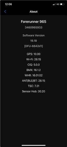

My garmin 965 turns off when a running activity is selected, roughly after 5 seconds it goes off. Or if the stop button is pressed during activity. Any suggestions to sort this out please.

Did you do a soft reset - Hold in power button until it turns off completely , then restart after say 20 secs.
Is it only the running activity? If so possibly do a reset settings on running activity from teh settings screen for teh activity. You will need to redo any data pages unless you have a backup of it, see note below on how to do a device drive backup.
When you says goes off after it is selected , is it the activity power save possible? if you take to long to press start
