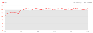

  • I'm using my watch since July 2023 and from the beginning it was very okay, seemed stable, very convincing - i was happy with it. But currently it's most likely a joke. Even today I had to stop during running, cause AGAIN my heart rate locked at 120-125bpm? After stopping running, stopping activity and taking off my watch I noticed that the green light is... absent. It wasn't measuring nothing... My HR chart below - at about 6:40 minutes into activity I stopped. What helped (for now) I turned off everything off - I mean sensors, headphones etc. Only left connection with my phone.
    I am very unhappy currently with performance of my FR965 and don't see any solution for making It better. Maybe I'll wait for next update or just sell this watch. For now I have feelings that I have an overpriced "kickstarter" watch and not a professional training tool what I was looking for.
  • Thank you for sharing, and I'm very sorry to read about this! We've been investigating OHR concerns during activities, and I'm happy to add you to our report. You can also follow the main FR 965 thread regarding this HERE.
