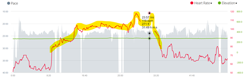

  • went for walking yesterday and my HR somtimes just went up for no reason. At the same time i was also wearing my huawei watch and my HR was perfect. Garmin can you fix this problem because this lasting at least a year already. You can see this on pictures below.

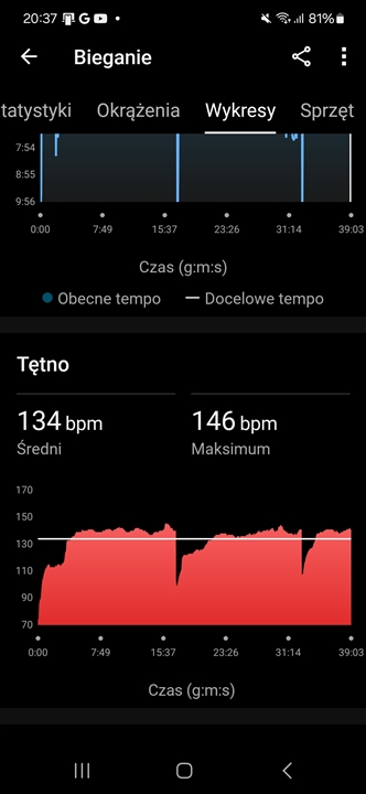

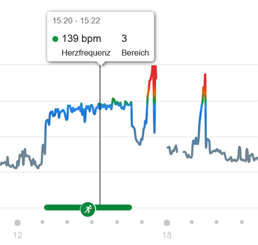

  • This is from a 5,1 km run last week which has been done at a relatively constant pace and load.
    From the beginning to the end not even one of the whr-measurements has been near the reality.

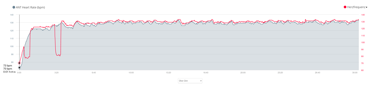

  • I see 2 problems in the WHR:
    1. it's 20-30 bpm too low, which is a huge problem. It means it's maybe worth than just putting my hand over my chest. And useless.
    However I also notice that it does correspond "pretty well" to the external HRM, they move more or less parallel to each other.
    2. Even if I disregard that it's too low I still see lots of small flat line sections, that means the optical sensor lost a few seconds of reading.
