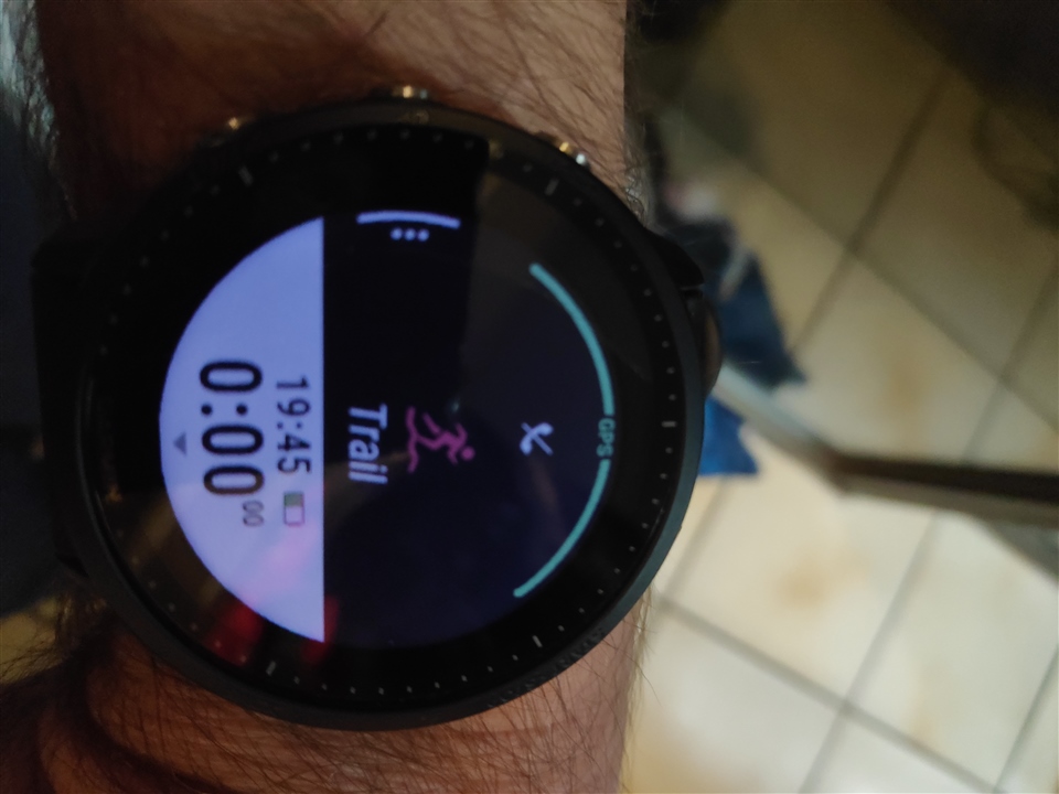

I have both versions. I have checked the user guide and it should be a heart icon flashing. There is no such icon in my watch. The watch whr should be ready when it stops flashing. Where is the icon?
Select (and do not start) an activity and it is right in the upper half of the display right in the middle.
I have noticed exactly the same thing - the heart icon never appears on my FR955, with latest firmware 21.20.
Go into SYSTEM, ABOUT and check what version your WHR is - it should be 18.01.06 - IF it is 0.0.0.0 then your FW upgrade somehow went wrong.
Also take a look at your settings for your activity type if pulse data is on/off. As far as I remember for Trail it is off.
