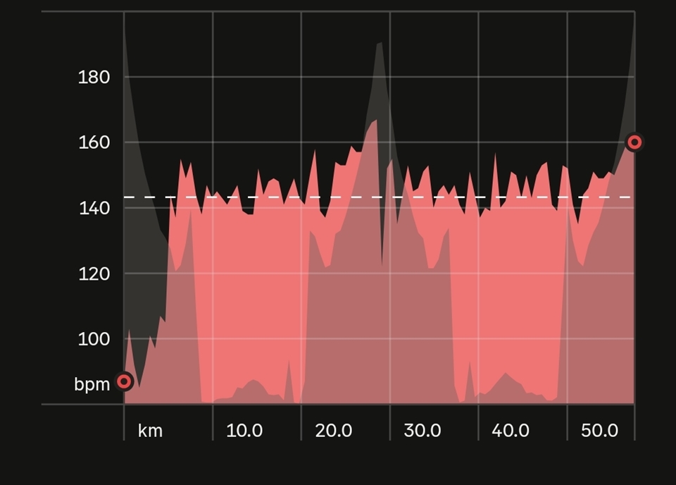

The HR is responsive enough. You can see that it rises with a slight delay, but then remains at a low level. Then the heart rate jumps up to the correct level (heart rate is from the HRM run). When the Wrist HR works right after some minutes, I think it works very well (see intervals).

Garmin has made the watch nearly useless, because the HR is the basis for all other metrics. (For the 3 minutes in the picture it may not be so serious, but for 10-15min it is serious).

  • I did another run today and the same problem occurred again. The watch didn't lock on to my heart rate for the first seven minutes of a run at 6.25min/km, and completely missed an interval of 4.4min/km. After 1km, it told me my performance condition was "+8", which was clearly nonsense based on the incorrect heart rate.
    After the run, the watch told me my lactate threshold had increased, but it's hard to know if this is real or because of the faulty recording.
    The problem is easy to see in the graph below - grey is heart rate, blue line is pace.
