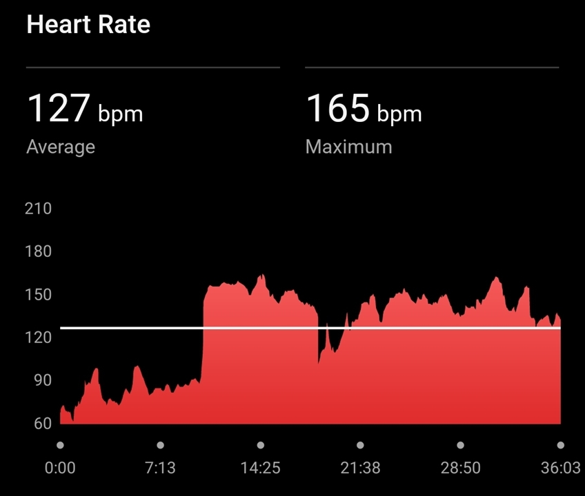

Today I updated the watch and then made a hardware reset to be on the safe side. After that I was running. The bug still exists in FW 21.19.
The HR is responsive enough. You can see that it rises with a slight delay, but then remains at a low level. Then the heart rate jumps up to the correct level (heart rate is from the HRM run). When the Wrist HR works right after some minutes, I think it works very well (see intervals).
I am absolutely unhappy with the situation. Garmin has a software bug since months which is also confirmed by support. But there is no solution. A return of the watch is denied and a downgrade will also be denied. All forum threads pointing this out have been closed.
Garmin has made the watch nearly useless, because the HR is the basis for all other metrics. (For the 3 minutes in the picture it may not be so serious, but for 10-15min it is serious).
