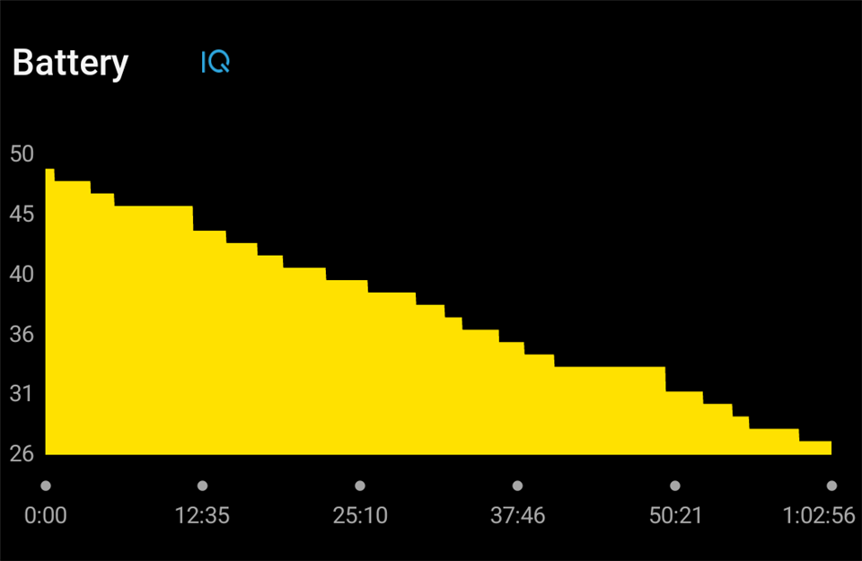

Just wondering if anyone else is experiencing extreme battery drain? Seems like my watch is losing battery life faster than before..I know it was an issue a year or two ago but started noticing this the last couple of months… Anyone else?
YES, 955 Solar, losing more than 10% a day with everything off (all comms and PulseOx). Before, when it was new or within the first year was half of that. After every update is getting worse. With full…
Similar situation. After the latest updates (20.26, 20.29 and 20.31) the battery discharge in normal use mode increased by about one and a half to two times. In activity mode, the battery discharge did…
I’ve tried to reboot, and it does not work… I think it’s 10%+ daily without even doing an activity and more when I do… crazy… sleeping I lose close to 6-7% (8 hours not 12 ha)…. Not much I can do I guess…
For now the only way to solve the drain is to disable all useless alerts including garmin share and, after an activity with gps, select one without, run it for a few seconds and then delete it. They fixed the problem with the new beta of fenix, we hope they did the same with ours from yesterday even if it is not mentioned in the log.
Ah, didn't see anything in the changelogs but reading the comments it indeed seems to be the case...
I just installed 21.14 beta last evening and so far still 0.5%/hr but not sure what I can expect given the age of my watch (2.5yrs now, perhaps battery performance also has simply decreased) and usage (always connected to phone nowadays).
Did just turn of jet lag adviser, will see if that makes a difference. Think I restarted the watch after the update as well, but if I still see higher usage (0.5%+/hr range) then I'll do it again just to be sure.
