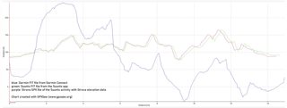

So I calibrated it before last weekend's MTB ride, also wore a Suunto Race watch, and compared Garmin, Suunto and Strava data.
The results seem clear: While the Suunto and Strava elevation profiles are almost identical, the Garmin elevation is not only slightly off, but drifts all over the place and is completely unusable.
Has anyone recently experienced similar issues and what have you done to fix it? Any advice what may be wrong and what I should do about it would be greatly appreciated.
