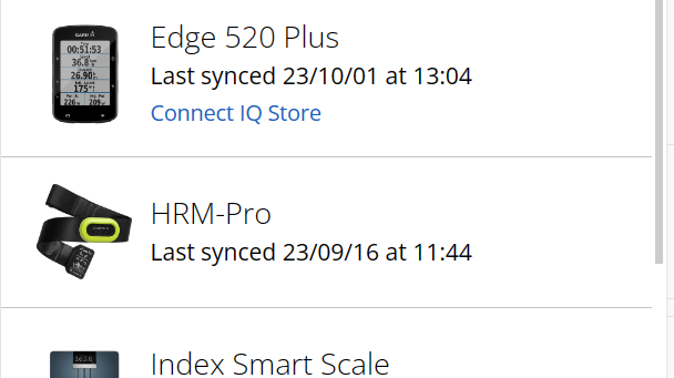

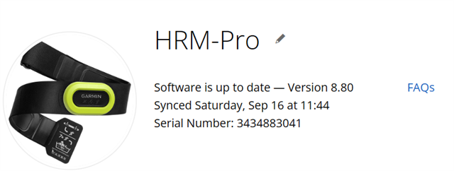

Interesting is that I am wearing HRM almost every single day and have it visible in all activities. Here is Last synced 23/09/16 - half year ago ;-)
The same here:
Last time I have seen battery in GCWeb was on Jan 16th

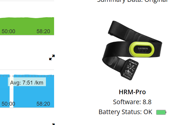

Yes, I do. There is a short info before starting the activity that it is connected with external hrm strap. Also it works without having the watch on the wrist (eg on bike). Overall it's not a problem, but to have an overview about battery would be a comfort function :-)
Yes it is strange.
