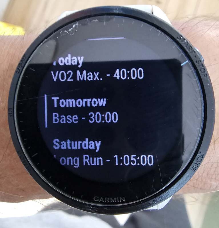

I am using 16.17 and currently training for a race. I registered it in Garmin without a time goal. Have been doing the suggested workouts for the past 3 weeks.

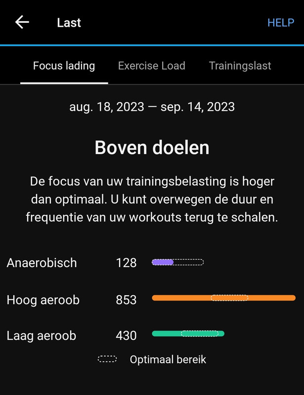

My Load Focus is now completely off the chart. Why is this not in sync? I would think the suggested workouts would be in balance with my fitness and training history (load balance) and not try to injure me.
Instead of giving me easier workouts or rest days I get a VO2 max and a long run.

  • My Load Focus is now completely off the chart. Why is this not in sync?
    You have exceeded the sweet spot zones of both high aerobic and low aerobic.
    At first glance, it looks like you have been exceeding the expected training load overall. Is this true? How is your training load doing? What is your load ratio?
    I can imagine other possible reasons that could contribute further to biases in the focus allocation. For example:
    - you have been over doing easy runs. For example, you ran base runs too fast and/or longer and they end up being rated tempo
    - your anaerobic training end up being rated tempo (high aerobic)
    Upon completion, how often does your workout label match the expected type?
    Finally, I see the watch is not expecting a specific focus on anaerobic, since your anaerobic sweet spot zone seems to be starting from zero. What type of race are you training for?

    my Load Balance tells me I should take a rest and pushing too hard.
    I just saw that. That confirms my suspicion. When I look at your load balance chart, the watch is expecting a maximum training load around 600. How do I guess this? The total of the beginnings of each sweet zone should be close to the top range of your ideal training load. In your chart, I guessed 0 for anaerobic, about 400 for high aerobic and about 200 for low aerobic were the lower limit for each corresponding zone.
    A the same time, you accumulated 128+853+430=1411 points for that period. So yeah, even if the evaluation is approximative, your went overboard.
    But I still get high intensity workout,
    Your out of bounds situation is not necessarily a showstopper if other elements of training status and training readiness, etc. are not pushing the algorithm to avoid high intensity trainings. Maybe you started using this watch very recently, or started training seriously recently and you have not ramped up your training load "green zone" enough, in comparison with your potential, maybe...
    My recommendation is:
    - if your workout TE is matching your workout goal for each workout type, take it easy and focus on keeping your training load below the max,
    - if you workout TE is not matching your workout goal, there is an issue with the metrics or training history.
