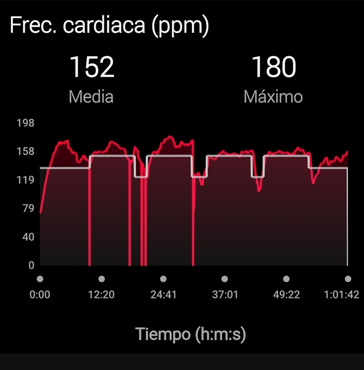

  • Hello again, this is my activity this afternoon. The first 2 series with DUAL BAND (TOTAL CHAOS), as you can see, the pulse is uncontrollable. The last 2 with the OPTICAL sensor of the FR 955 (SFW 14.15) are if they could be controlled and run the training. Could it be the band? or the software (14.15) does not provide us with a reliable connection to external sensors?

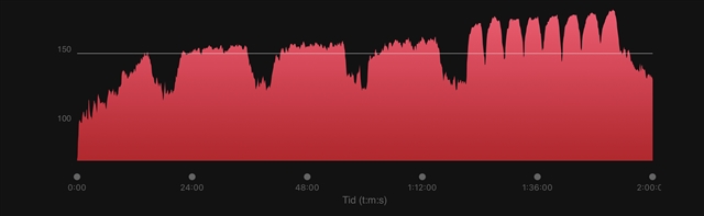

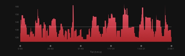

  • I noticed the same thing today during a 2h indoor bike ride. My heart rate was ”stuck” on the same heart rate for several minutes, which easily can be seen in the picture below. I did the exact same workout last week (on erg mode so i mean exactly the same) and one can easily see a huge difference in heart rate. Last week I was on FW 14.13, today FW 14.15. This is not good at all garmin, it messes up everything…
    The heart rate comes from a Wahoo tickr heart rate monitor which I’ve been using for all my workouts for the past years without any problems.
    Heartrate from today’s workout
    From today’s workout on FW 14.15.
    Same workout last week on FW 14.12
    The exact same workout from last week on FW 14.13.
    Please Garmin, this is a huge bug and should be looked in to asap!
