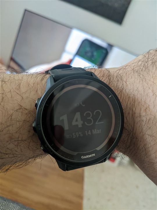

  • First of all, I hope you get better soon. I also had my ankle injured twice during the last month, and it's pretty annoying having to stop so suddenly
    My config would be, more or less, this:
    • BT ON
    • WIFI OFF
    • Touchscreen OFF
    • Stock watchface without seconds
    • HR ON
    • PulseOx On Demand
    • Notifications OFF
    One thing I usually do is keeping the watch charging for half and hour after It has reached the 100% mark. I think the watch is NOT on full charge when the number appears (quick charge) and I prefer to make sure it's fully charged keeping it charging for a little more time.
    My firmware is 12.29, the one that came out of the box.
    And this is the stock watchface I use.

  • Hello everybody! :D
    Small update, since yesterday I reached 50% battery:
    • 50% battery
    • 12 days since full charge
    • 4 activities (running)
    • 228 minutes of GPS Only (almost 4 hours)
    I'll post the final data when I decide to charge the watch again (I won't push the battery to 0%). It will then be my fourth full charge.
    Have a nice day and a better weekend!
