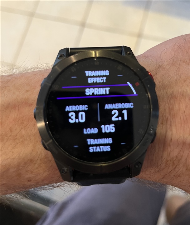

  • I have version 12.27 and I did Anaerobic training today .. warmup, 13x40s (200m) @3:25 w active jog recovery, and cool down... I got Tempo primary benefit... I think it should be Anaerobic primary benefit.
