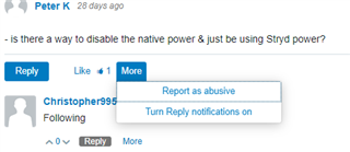

Garmin native power - is there a way to disable the native power & just be using Stryd power?
