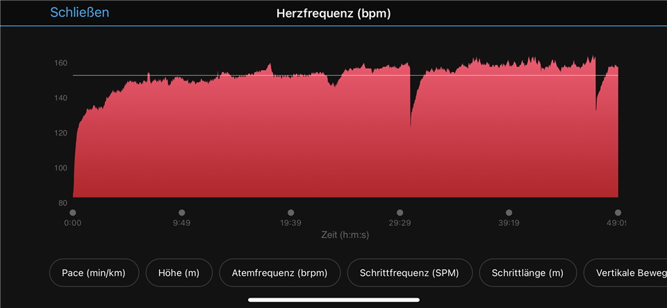

    Apparently the heart rate on it is varying too much and means no VO2 max is being recorded. It's changing by up to 5 bpm over a few seconds. They asked me to say the HR monitor used (HRM Tri) and suggested that I see if it's broken. Not so helpful. I've asked more questions but they're yet to reply.

  • I use mostly my HRM tri, which works also fine with my edge 1000. in minor cases I use a tickrx or wristbased HR reading. All of these combinations worked perfectly until July 19th, the last VO2max etc were calculated. Attached an example of my HR readings with the HRM tri 10k, Appx. 50 min.(the drops are traffic lights).
    calculation of VO2max on the bike using the tickr x and hrm tri continues without issue on my edge 1000. therefore it is definitely my watch which has the issue.
