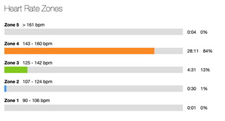

    • Heart rate must be elevated to at least 70% of your maximum heart rate for at least 10 minutes continuously
    Check that you got at least 70% of your max heart rate for at least 10 minutes continuously. Maybe your max heart rate is set too high?
    Yes.
    Not too high.

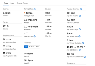

    The activity was copied correctly to Garmin Connect and I see all data: GPS track, pulse and etc.
    But the statistic on Website’s page: Reports -> VO2 Max doesn’t update for months.
  • I see my running activity on June 13, 2021 in Garmin Connect.
    There is VO2 Max on my watch - 49.
  • I guess VO2 Max from "all activities" (shown in your screen clipping) is the same as VO2 Max from "Running" (not shown in your screen clipping)?
