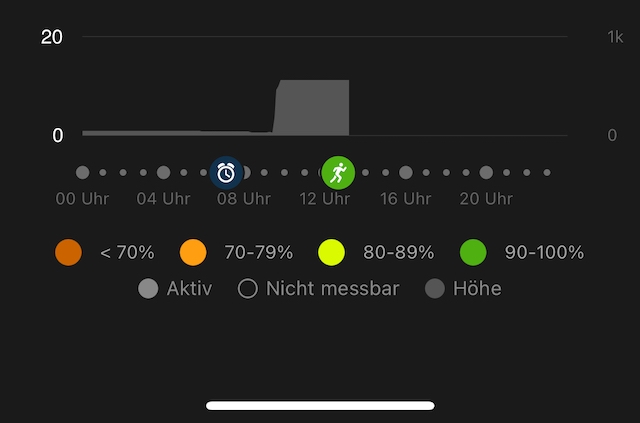

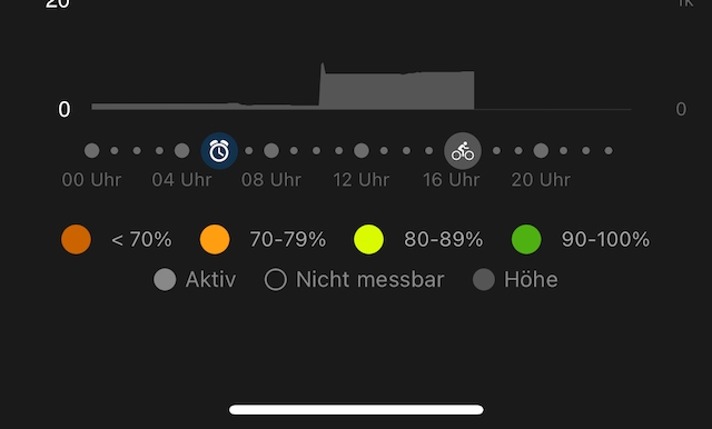

I am a helicopter pilot and fly at different altitudes.
Since 10 days my FR945 seems to miss my landings. The altitude goes up (roughly correct) but not down again.
Anyone experiencing the same?

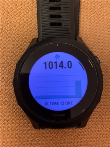

Hi, there were likely some related changes in 6.20. In my case after update watch barometer auto mode doesn't work like before. While driving to slightly elevated place (say 250->700m) watch doesn't recognize…

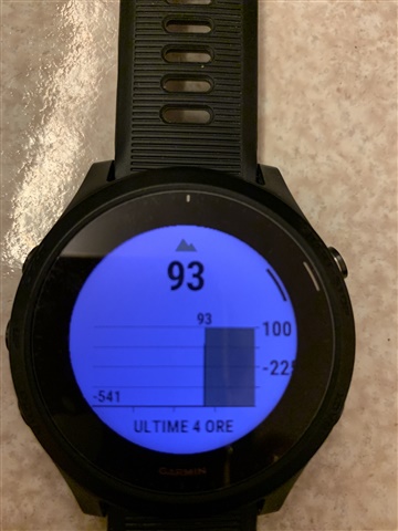

Something is going on. I don't know if you use meters or feet for elevation, but there shouldn't be an instantaneous change from -541 to 93 on your elevation graph either way and the same with the barometer…

Hi, there were likely some related changes in 6.20. In my case after update watch barometer auto mode doesn't work like before. While driving to slightly elevated place (say 250->700m) watch doesn't recognize the changes happening under way. When checking altimeter at the 700m place altimeter reports 250m and watch fires storm alert (or fires that after some certain time on its own). During activities altimeter is fine.
Hello, the same thing is happening to me too: it is as if the altimeter "falls asleep" when there are large changes in altitude (eg driving the car in the mountains). And then the storm alarm appears to me too, but the altitude is also wrong by 150 m. So far no problem when recording activities in the plains. The problem appeared from firmware 6.20: will it be a software problem?
