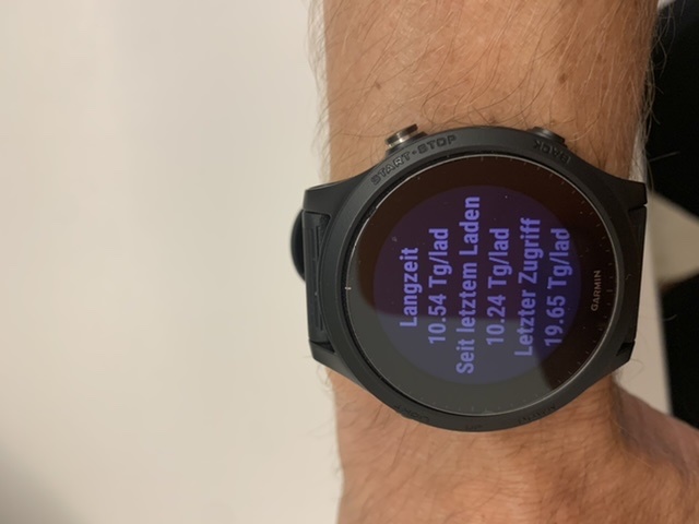

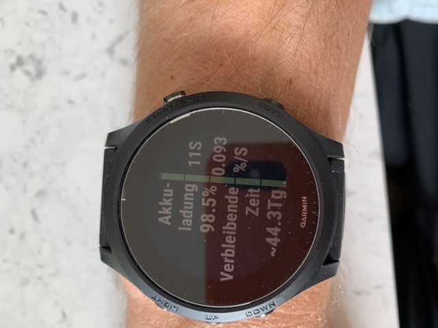

  • Thanks all of you for our answers and insights on your setup!
    Meanwhile I‘ve made some adaptations to my setup and the outcome is great (so far):
    • BT & Wifi ON
    • OHR ON
    • PO OFF
    • Changed WF to standard FR945 (as shown on the box)
    • Notifications ON
    • Backlight only when pushing buttons
    As well I deleted both pre installed music apps (Deezer & Spotify), made the adjustments as indicated here
    https://forums.garmin.com/sports-fitness/running-multisport/f/forerunner-945/212183/high-battery-drain---potential-workaround
    and now it seems perfect for me:
    So basically this is just the watch w/o any activities made but I‘m heading to an 2 hour run now so I‘ll let you know what happens next Pray tone1

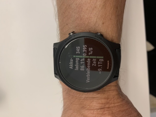

  • UPDATE
    Since yesterday the status is the following
    In the meantime I did a 2 hours run with GPS + GLONASS ON and also a new BT SW has been updated overnight.
    From my end I‘m now fine with my battery behavior and settings.
