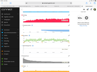

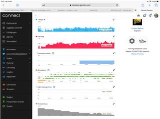

  • I am having issues as well with my hrm run. At first i have a much higher heart rate. Si i changed the battery.  It didn’t help. Bu now the heartrate is about normal but i don’t have my breathing count it is 20 per minute flat out. Also cadence is “disturbed. I am on fw 4.41. All this happened since  fw4.41.
  • Two runs about same Intensity one on fw 4.40 and second on 4.41
