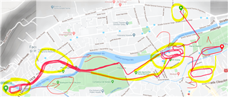

  • i'd say it's a hit and miss; this is undoubtedly the worst track ever, recorded today:
    https://connect.garmin.com/modern/activity/4860573055
    i don't know how on earth was it even possible to shift itself that many times :-). gps + glonass, latest beta, 1 sec, etc.
