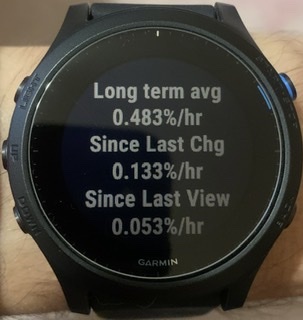

Final update...seems good:
I'm at .17%/hr at 95% remaining ...seems so far lower than 3.3. Here are my settings in case they help anyone:
1) Wifi = off
2) Garmin pay = on
3) All day PulseOx = off
4) Activity PulseOx = off
4) Backlight = always off
5) Sounds = off
6) Vibration = on
7) Smart notifications = on
8) TrueUp = off
9) Activity tracking = on
10) Widgets = Notifications, Weather, Calendar, Stress, PulseOx, Heart Rate, Performance, Training Status, Battery Monitor
11) Music Providers = Control Phone
Running a test for the next few weeks with no activities.
Update: .203%/hr at 90% remaining (tracking this here mostly for my own curiosity)
Update: .215%/hr at 80% remaining
Update: .25%/hr at 67.5% remaining
Update: .26%/hr at 60% remaining
Update: .257%/hr at 50% remaining
Update: .248%/hr at 40% remaining
Update: .277%/hr at 30% remaining
Update: .285%/hr at 20% remaining
Update: .286%/hr at 10% remaining
