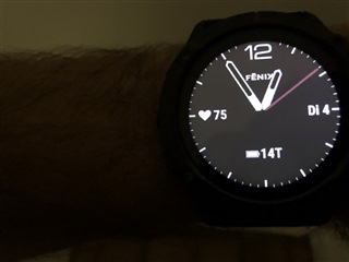

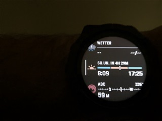

I bought two fenix 6’s today, both are the Carbon grey DLC coated with sapphire glass.
Have a look at these photos, my wife's is on the left hand side and mine the right. Her looks very yellow compared to mine which looks far crisper and sharper. Both have backlight set to 50%.
Any thoughts on if there’s a setting other than backlight that could cause this before I go back to the shop where I bought them?

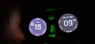

  • Here is mine,  just got it in from rma process, brand new sealed box. Im exchanging my current one with the new one due to hrm, clicky button,  and now the purple screen!! Same fenix 6x sapphire model.  Did not know how good actual black looks like! Feels like the original is a chinese ripp off...
    New
    Still new
    Red is old, pink screen apparantly
    Notice the nice, i guess black gray...
    Obviously they are not same fw, just took it out of the box.
    Left fw 6, right fw 4.2
    Did not check hrm yet, did not check viewimg angles, did not check anything else lol.
    Should if fe upgrade it to fw 6... or test and if hrm good, stay on it? I see some reported hrm is fine on 6 , but hrm worked prior.. soo ... roll the dice??
  • Ps.. the difference is MUCH clearer in original photos than after the upload here... odd
  • I know right? I didn't think of it much either... till my replacement for clicky back button and poor hrm in everything.  Still need to test hrm tho lol

  • Concerning the display, there is some evidence Garmin actually uses two different display technologies in the same watch, based on HW revision or even production date. Watch this video
    https://www.youtube.com/watch?v=J8XZ_lsGGtI
    It compares the F6 Pro and Sapphire versions. Here you will clearly see that the reviewed Pro has much deeper blacks while the Sapphire has a "washed out" look and bluish hue, like some 945 - while other 945 have the deep blacks. It seems more likely that you just got the bluish Sapphire and the deep black 945. My 945 has exactly the same display look like the Sapphire by the way...
    I guess if you would order 10 Sapphires from 10 different vendors and 10 945s from 10 different vendors, you might end up with a nice set of different displays on each variant...
  • That’s very likely to be the reason. Still, not what you would expect from a big company...
    Btw, that video you posted was the reason why I tried to go for the Sapphire one. I thought, let’s try the one with a “normal” display so I can judge fairly...

  • I have a 945 with great display.
    Then I got a 6X Pro with Gorilla glass - with blue tint - like my old Fenix 5x had. I did not like that.
    Then I got a 6X Pro with “Solar Glass” for a steal - and that has the great display.  So “old” 6X went on eBay.
    So it is not only Sapphire glass.
    Only order from companies that accept returns and continue until you get a good one. Or buy in from high street retailer where you can see before you buy. Some serial numbers ranges “seem” safe - but not many retailers will give you serial numbers of their stock.
    And I agree with you - that is not what you should expect from Garmin. The quality of the displays should be equally good (or bad) no matter which production run you get.
