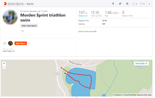

  • Another swim worked, 750m Sprint triathlon swim. Used GPS only
