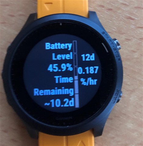

  • Hi Snortingbull- yes I understand what you are saying :) The battery widget says the battery usage is x2 for the 945 vs 935. Question for you - have you run the battery down to say 5% or so?  Initially my 945 showed high battery usage until I did 3 things 1. Loaded 2.50  2 Hard reset and 3. Ran the battery through full charge - discharge a couple of times. Now I’m getting 0.185% per hr. Which is better than spec. Yes maybe not as good as your 935 at 0.15%.  Sorry to hear you are having a problem- maybe you should swap for another watch. Anyway as I said I’m happy enough with my 945 for my purpose.

    My battery usage is 0,456/hour
