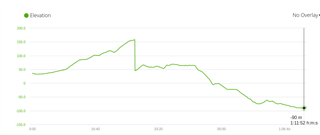

  • Hi Garmin-Sierra,
       This is from this Saturday... In the end I was running 90 meters below the sea level... and that's wrong for more than 100m. Before the correction, altitude was quite accurate... the "correction" was just wrong, uncalled, not necessary.
       This did not happen when I bough the watch, as some others have said before. As downgrading the firmware to version 10.40 solves it (not an acceptable solution for me), seems a software problem.
       So the suggestion is to reach my local Garmin Product Support agent, for what? To RMA the unit and getting another one that will exhibit the same behaviour, as others have experienced? Am I at least allowed to upgrade to another model (paying the difference) without this glitch? (it is a rhetorical question, I guess the answer...)
       I don't know... just not allowing the altitude "corrections" to happen during an activity would do the trick. Is not the glitch itself what is worrying, is the apparent Garmin inability (willingness?) to solve it what worries me.
