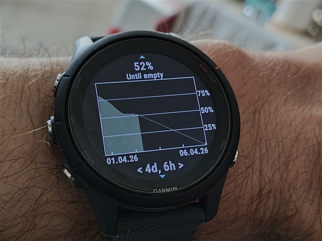

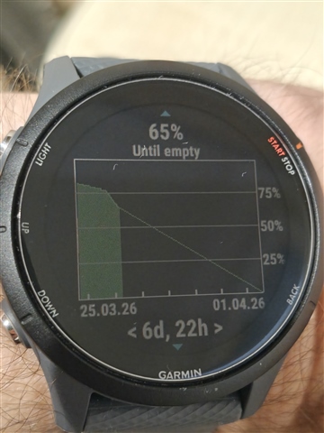

After completing an “Indoor Bike” activity (~25 minutes), the battery discharge rate becomes significantly higher than normal.
Key observations:
  1. The increased drain begins immediately after ending the Indoor Bike activity.
  2. Restarting the watch via the menu does NOT resolve the issue.
  3. Performing a forced reboot (holding the Light button until shutdown) restores the normal discharge rate.
  4. The issue is reproducible.
  5. At the moment, Indoor Bike is the only activity I am using (due to injury), so I cannot confirm if other activity types trigger the same behavior.
I have attached screenshots from the “Battery Graph” Connect IQ application:
  • Yellow circle: 25-minute Indoor Bike activity.
  • After activity: noticeably steeper discharge slope.
  • Red circle: forced reboot.
  • After reboot: discharge slope returns to normal.
The behavior strongly suggests that something remains active after the Indoor Bike activity ends, causing excessive battery consumption until a hard reboot is performed.
