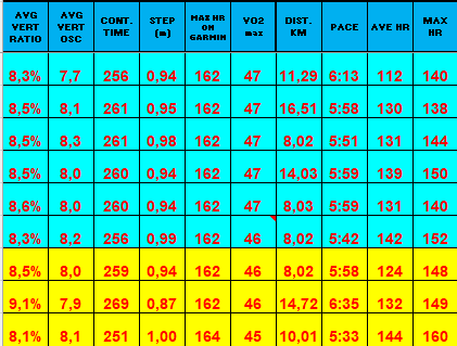

  • As far as I understand, VDOT is a basic indicator of run result as only consider distance and pace and you can get increased values only if you run faster, without attention to your heart rate. What worth this to? 2 people covering the same distance with same time but different HR, have same VDOT but different VO2max.
    I am checking and record my VO2max after every runs, and I am stable at 46 while some weeks ago I was 44. The increase from 44 to 46 due to my HR max decreased, and my HR is sensibly decreased of ca. 7-8 units running at 5:40, imho.

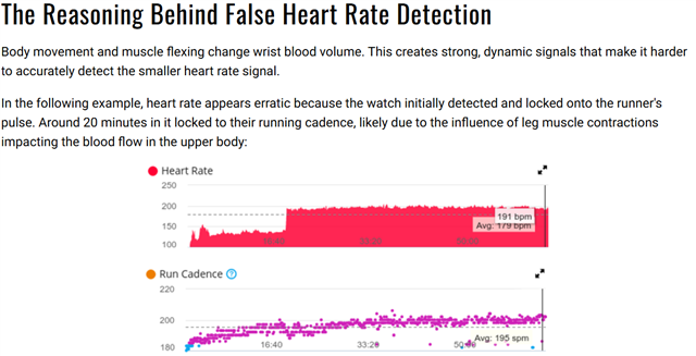

  • as far as I understand, VO2 max is highly depending on HR vs pace: if I run slowly with HR very limited (ca.120) VO2 max decreases, while I could attend to increase, but that's not.
    I relized the fixing of the watch to the wrist, it must be perfect to evaluate correctly HR. In fact, I think my VO2 max was increasing from 45 to 47 due to wrong measurements (unfortunaletly!) as it measured less than the reality.
