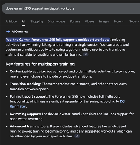

    For similar reasons, AI/LLMs such as Google Gemini will also misleadingly claim that Forerunner 255 supports "multisport workouts", depending on how you ask.
    Notice how Gemini's response (fully screencapped above) makes no mention of the nuance I mentioned above, because it's just an LLM and not an actual person who knows anything about Garmin products or is able to infer what was really meant by "[Garmin] multisport workouts" in the first place.

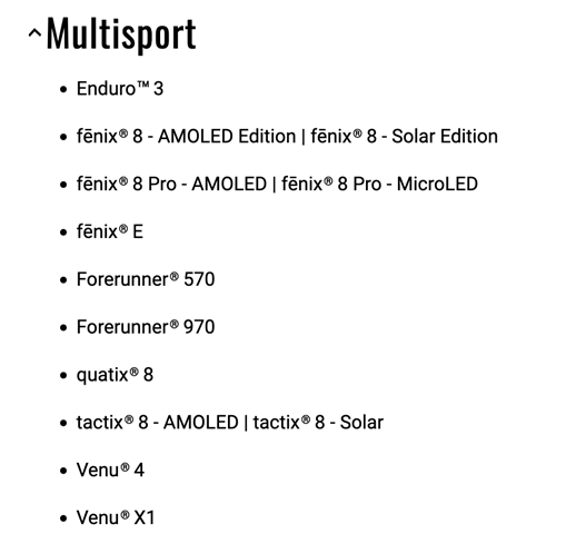

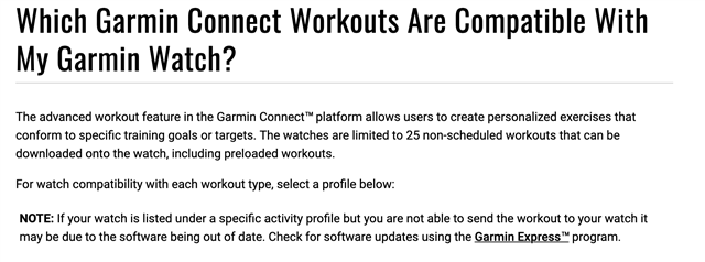

    Hopefully this Garmin support article will make it clear which devices actually support multisport workouts:
    https://support.garmin.com/en-CA/?faq=lLvhWrmlMv0vGmyGpWjOX6
