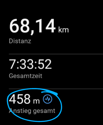

My watch shows a too high altitude difference for gpx tracked tours. Example: Cycling tour with someone with Fenix. We both had identical distance values, but the difference in altitude was 500 meters for me and 350 meters for him. How can that be? I already tried the options: multi Satellite, best precision, but Same behaviour. Any idea?

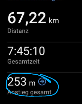

  • Example. Mine is 458m, his shows 253m. Is this really from barometer and not gpx?
