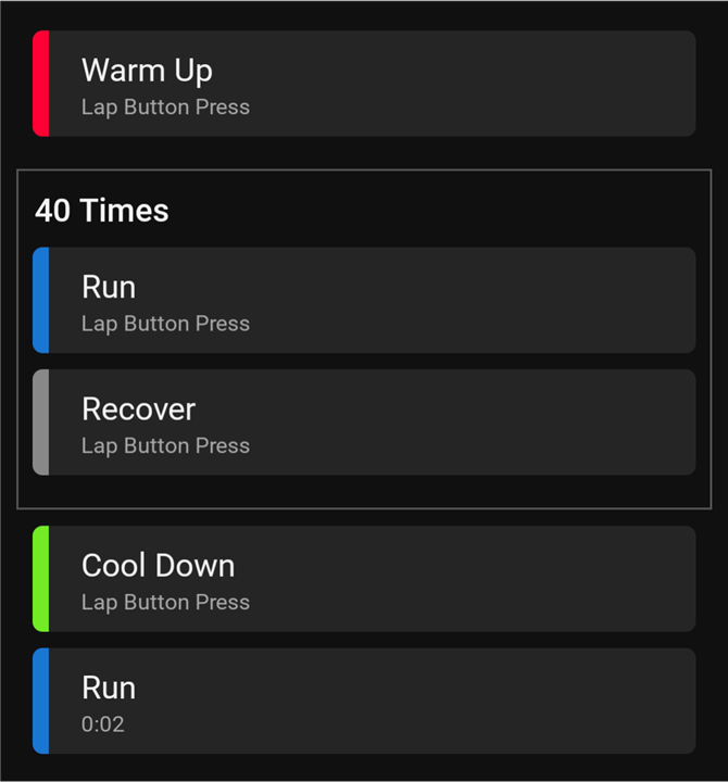

  • Yeah... There is no logic for nested objectives like 'For the next 24 minutes Do 10 times xxx'. Not with Garmin, nor with Coros or Suunto (the manufacturers where I have experience).
    You'll have to use a maximised open structure based on Lap presses (or time/distance within the Rep section) and then end the workout - when the 24 minutes have expired - by long pressing the Up button and selecting 'Cancel Workout' (Edit: The middle button on the left side of the watch... I erroneously first said long press the Lap button...). After that the session is still running so you can do the Cool Down until you press Start/Stop as usual. Here's a picture I just did with Garmin maximum Reps:
    Obs: The last step with a few seconds running is because Garmin lately have made it impossible to end a structured workout by 'Lap Button Press'.
