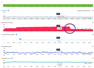

Using Forerunner 255 (former user of Forerunner 235 for 7 years), noticied that after about 50 minutes running and reaching 160bpm, it suddenly went to around 100 bpm.
Is it related to sensor? Outside temperature was about 18-20 degrees.

It is not so strange that it acts like that. The sensor picks up a noisy signal. The algorithms in the watch will continuously try to determine which of the many frequencies that is your heart rate. Some…

It also happens to me a few times per year and every time i remember me fixing the strap of my 255 either from being too loose, being to tight, or having caught part of a sleeve.
The strange thing is that it does not recover by itself even if i remove and wear again the watch or pause it. Most of the times if i stop and start a new activity it also keeps reading wrong HR.
At least once after starting a new activity unsuccessfully, i rebooted it and still read wrong. Other times this is has fixed the issue.
My advise: Just fix the watch strap properly and try not to mess with it while running.
this happens to me at least a few times every run using a brand new 255. my running cadence is around 160 spm and when operating in high aerobic my HR is often around there as well.
i typically see several "events" in my run where the heart rate will drop from 150 or 160 to 120 with no warning, and then either jump back up if i adjust the strap, or slowly creep back up over several minutes. this problem existed with the forerunner 55, but is now completely out of control with the forerunner 255, ruining the HR data on most workouts. at this point my 55 is the superior device for hr monitoring despite having what is usually described as a "simpler" optical HRS.

UPDATE 3 MONTHS LATER: Soon after a series of events like this, I returned the Forerunner 255 and bought a Forerunner 955. Since then (around 2-3 months) I have used the 955 without any error or false reading. My conclusion was that the particular device F255 was defective. I am very happy and confident with the Forerunner 955.
